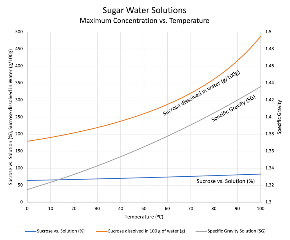

Solubility of sugar in water.
Maximum solubility of sugar in water vs. temperature
  • Sucrose vs. Solution (%)
  • Sucrose dissolved in 100 g of water (g)
  • Specific Gravity Solution (SG)
- is indicated in the chart below.
Sugar Water Solutions - Maximum vs. temperature
