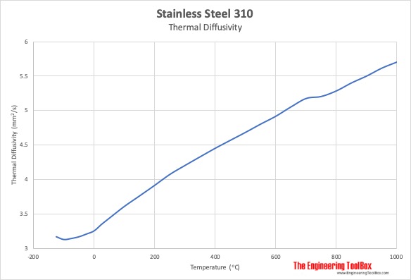

Thermal diffusivity
Stainless steel 310 thermal diffusivity vs temperature

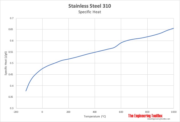

Specific heat capacity
Stainless steel 310 specific heat vs temperature

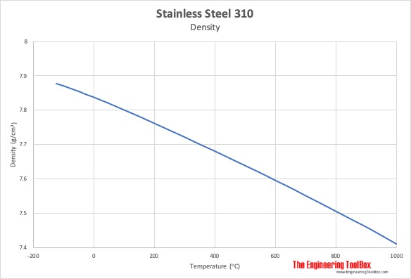

Density
Stainless steel 310 density vs temperature

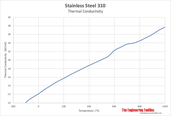

Thermal conductivity
Stainless steel 310 thermal conductivity vs temperature
AISI 310 Stainless Steel - Properties
Temperature
(°C)
Thermal Conductivity
(W/mK)
-125 9.4
-100 10.1
-75 10.8
-50 11.2
-25 11.7
0 12.1
25 12.7
50 13.2
100 14.1
150 15.0
200 15.8
250 16.6
300 17.3
350 18.0
400 18.8
450 19.4
500 20.1
550 20.9
600 22.2
650 23.0
700 23.7
750 24.0
800 24.5
850 25.2
900 26.0
950 26.9
1000 27.7
