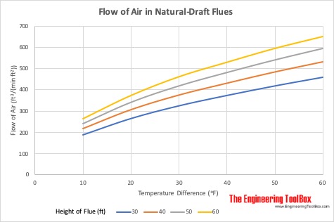

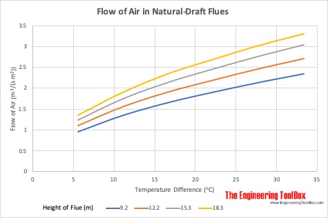

Flow of Air in Natural-Draft Flues
Flow of Air in Natural-Draft Flues - feet and fahrenheit
Flow of Air in Natural-Draft Flues - meter and celsius
