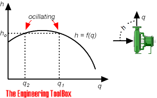

For stable head-flow characteristic the differential head - h - progressively falls with increasing flow rate - q.
Centrifugal pump - stable flow
For unstable head-flow characteristic the differential head - h - rises to a maximum and then progressively falls with increasing flow rate - q.
Centrifugal pump - unstable flow
An unstable pump may start to oscillate between the two possible combinations of head-flow. The flow rate will modulate and the pipeline vibrate.
It is recommended that centrifugal pumps are designed and operated under stable conditions.
