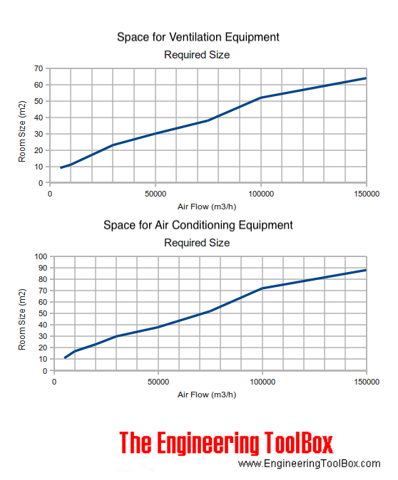

Required size of ventilation and air conditioning rooms according DIN 1946.
Typical required sizes of ventilation and air conditioning rooms according DIN 1946:
required size of ventilation and air conditioning rooms
  • height of room ranges from 2.4 to 4.5 meters
  • width of room ranges from 2.0 to 6.6 meters
