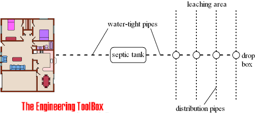

Septic systems handles waste from drain systems.
Septic systems handles the waste from drain systems in buildings, normally by processing the waste through septic tanks and leaching areas.
Sewage - Septic system
Solid waste and grease are retained in septic tanks and effluent waste water are disposed into the ground by leaching systems.

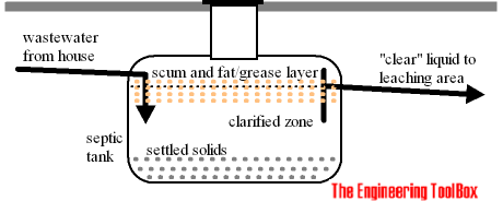

Septic Tanks
Scum and fat/grease are floated to the top of the tank. Solids are settled in the bottom.
Sewage - Septic tank

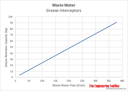

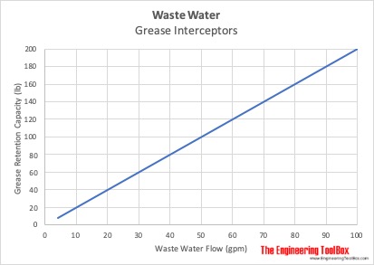

Grease Interceptors
Required grease interceptor capacity:
Waste water grease interceptors capacity
Leaching Fields
The size of the leach field are determined by two main factors.
  • the loading rate or the amount of wastewater that goes out to the leach field on a daily basis
  • The soil percolation or absorption rate - the rate at which the liquids will pass through the soil
