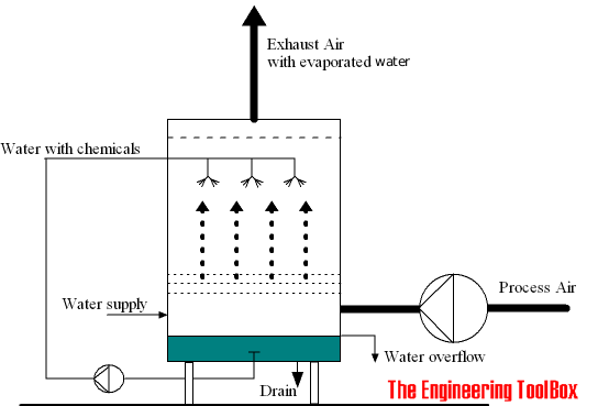

A schematic drawing of a typical spray nozzle scrubber configuration is shown below.
scrubber
Water with chemicals are sprayed with high pressure through nozzles into the air flow. Some of the water evaporates, especially if the process-air is hot, and disappear with the exhaust. Water droplets are separated from the exhaust and re-circulated back to the water reservoir. Evaporated water is replaced by fresh water and chemicals. Dust and pollution products from the process are removed periodically through the drain.

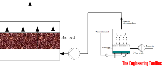

Some industrial processes need more cleaning than a single scrubber can provide. In smell polluted processes, like exhaust air from fish meal or fish feed dryers, bio beds are commonly used. A bio bed, which is an organic organism, require process air with as little dust as possible and temperature and humidity within certain limits.
scrubber and bio bed
