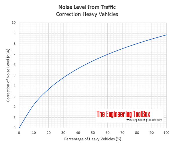

Noise level from traffic chart - correction heavy trafficDownload and print Noise Level from Traffic - Correction for Heavy Traffic chart
Example - Traffic noise from a road
From the first chart the hourly noise level from a road with 100 vehicles per hour and speed 75 km/h can be estimated to
62 dBA
If the percentage of heavy vehicles is 15% the last chart indicates that
3 dBA
must be added.
It can be assumed that the hourly noise level is approximately
62 dBA + 3 dBA = 65 dBA
