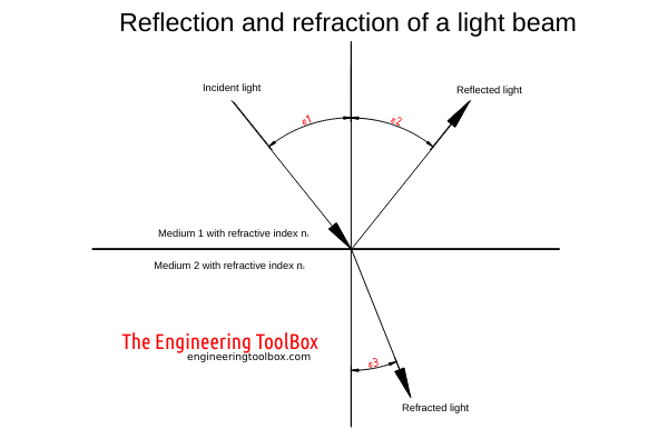

Refraction is an effect that occurs between transparent materials of different densities.
The Refractive Index  - n - of a medium is a measure for how much the velocity of light is reduced inside the medium. The velocity of light in a medium can be expressed as
v  = c / n                                          (1)
v = velocity of light in the medium (m/s, ft/s)
c = speed of light in air or vacuum - approximately 3 108 m/s (or 299792458 m/s)
n = refractive index
The index of refraction is defined as
  • "the speed of light in vacuum divided by the speed of light in the medium".
Eq. 1 modified
n  = c / v                                          (2)
