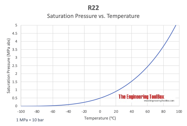

R22 - Saturation pressure vs. Temperature
