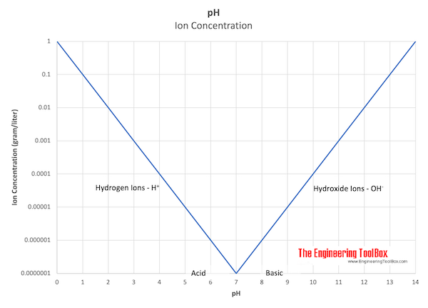

pH values are calculated in powers of 10. The hydrogen ion concentration in a solution with pH 1.0 is 10 times larger than the hydrogen concentration in a solution with pH 2.0. The larger the hydrogen ion concentration - the smaller the pH.
  • when the pH is above 7 the solution is basic (alkaline)
  • when the pH is below 7 the solution is acidic
In pure neutral water the concentration of hydrogen and hydroxide ions are both 10-7 equivalents per liter.
pH - Ion Concentration
pHIon Concentration (gram equivalent per liter)Type of Solution
0 1.0 Acid Solution
- Hydrogen ions -
H+
1 0.1
2 0.01
3 0.001
4 0.0001
5 0.00001
6 0.000001
7 0.0000001 Neutral Solution (pure neutral water)
8 0.000001 Basic (alkaline) Solution
- Hydroxide ions -
OH-
9 0.00001
10 0.0001
11 0.001
12 0.01
13 0.1
14 1.0
pH vs. Acid Hydrogen and Basic Hydroxide ions
Download and print pH Ion Concentration Chart
