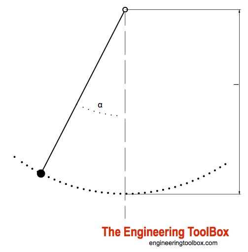

A simple pendulum oscillates in the vertical plane due to gravity.
A simple - or mathematical - pendulum consists of a rigid body suspended from a fixed horizontal axis about which the body may oscillate in a vertical plane due to the action of gravity.
simple pendulum ocillating due to gravity
The oscillating period for a simple pendulum can be calculated as
T = 2 π (l / ag)1/2              (1)
T = oscillating period for one cycle (s)
l = length of the pendulum (m, ft)
ag = acceleration of gravity (9.81 m/s2, 32.17 ft/s2)

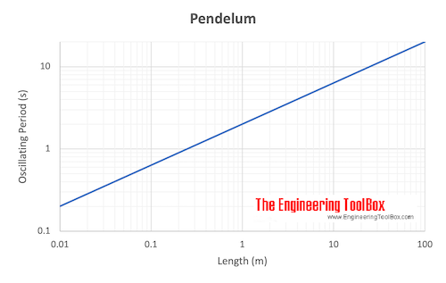

Example - Calculate the length of a pendulum with an oscillating period of 1 sec, 10 sec and 100 sec
The length of a pendulum with a given oscillating period can be calculated by transforming (1) to:
l = (T / (2 π))2 ag
Length for 1 sec - typically for an old fashion pendulum clock:
l = ((1 s) / (2 π))2(9.81 m/s2)
  = 0.249 (m)
Pendulum clocks were the world standard for accurate timekeeping for 270 years until the quartz clock was invented in 1927.
Length for 10 sec:
l = ((10 s) / (2 π))2(9.81 m/s2)
  = 24.9 (m)
Length for 100 sec:
l = ((100 s) / (2 π))2(9.81 m/s2)
  = 2487 (m)
Pendelum Oscillating Period chart
