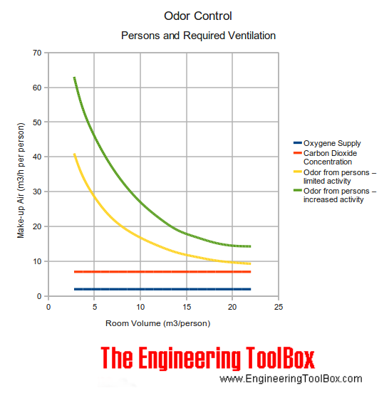

Odor from Persons - Required Ventilation
Required air ventilation to handle odor and smell from persons.
Required make-up air to
  • keep a minimum required oxygen level
  • avoid unwanted carbon dioxide level
  • keep odor or smell from persons within acceptable limits
Odor control persons make-up air
  • 1 m3 = 35.31 ft3
  • limited activity - persons sitting relaxed, watching cinema ..
  • increased activity - persons standing, doing shop, laboratory activity ..
