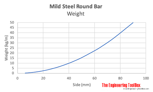

Mild Steel - Round Bars Weight
Weight of round bars.
Weight of mild steel round bars can be calculated as
W = 0.0062 d2                            (1)
W = weight (kg/m)
d = round diameter (mm)
Bar Diameter
(mm)
Weight
(kg/m)
6 0.22
8 0.39
10 0.62
12 0.89
16 1.58
20 2.47
25 3.85
32 6.31
40 9.86
45 12.5
50 15.4
60 22.2
65 26.0
75 34.7
90 49.9
100 61.6
Mild steel round bar - weight
