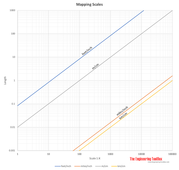

Mapping scales - Converting table length and area
Download and print Mapping Scales Chart

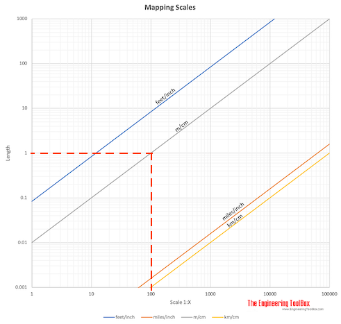

Example - Mapping Scale 1:100
Mapping scales - Converting table length and area - example 1:100
The scale of a drawing is 1:100.
The 1:X factor according the table is 1.0 m/cm. 1 cm in the drawing equals
(1 cm) (1.0 m/cm) = 1 m
in the real.

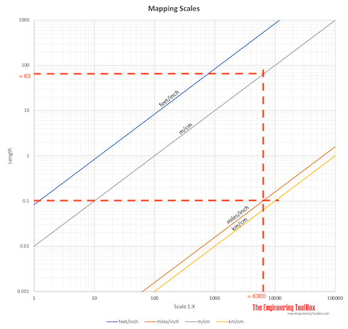

Example - 0.1 miles/inch vs. scale and m/cm
As illustrated in the figure below 0.1 miles/inch corresponds to scale ≈ 1: 6300 and ≈ 63 m/cm.
Mapping scales - Converting miles/inches to m/cm - example 1:100
