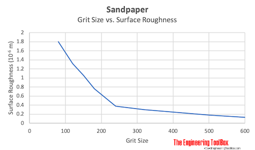

Grit Size vs. Surface Roughness
Comparing sandpaper grit size and surface roughness.
sandpaper grit sizes
Approximate comparision of sandpaper grit size and surface roughness:
Grit SizeSurface Roughness
(10-6 m)
80 1.80
120 1.32
150 1.06
180 0.76
240 0.38
320 0.30
500 0.18
600 0.13
Sandpaper - grit size vs. surface roughness
