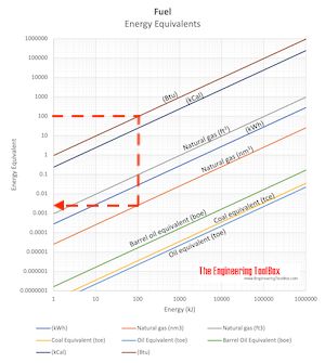

Fuel energy equivalents chartDownload and print Fuel Energy Equivalents chart
Example - Convert from Btu to Natural gas nm3
The equivalent of 100 Btu energy can be approximated to 0.0025 nm3 of natural gas as indicated in the chart below.
Fuel energy equivalents chart - example
