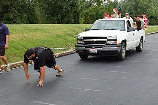

Example - Strong Man Pulling a Truck
Strong man pulling truckBy stu_spivack [CC-BY-SA-2.0], via Wikimedia Commons
A "strong man" is pulling a truck by exerting a force of 1000 N. The force is acting 30o to the horizontal plane.
The horizontal force on the truck can be calculated as
Q = (1000 N) cos(30o)
   = 866 N
   = 0.87 kN
The vertical force "lifting" truck can be calculated as
P = ((1000 N)2 - (866 N)2)1/2
  = 500 N
  = 0.5 kN
