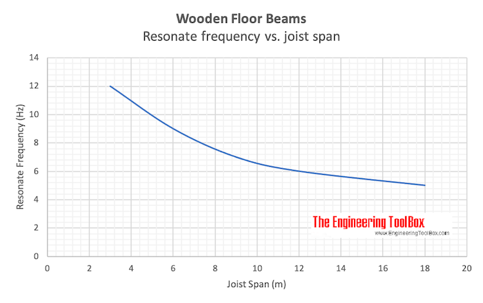

Typical resonate frequencies in wooden beam floors are
  • Joist span 3 m : 12 Hz
  • Joist span 6 m : 9 Hz
  • Joist span 9 m : 7 Hz
  • Joist span 12 m : 6 Hz
  • Joist span 18 m : 5 Hz
Wooden floor beams - resonate frequencies vs. joist span
