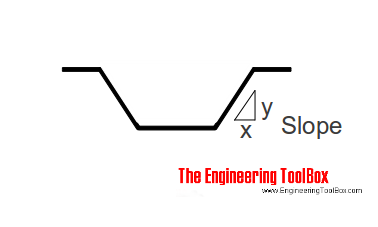

Calculating excavation slope.
excavation slope
Excavation Slopes
Excavation Slopes vs. Type of Soils
Type of SoilSlope
(x : y)
Solid rock, shale or cemented sand and gravels 0 : 1
Compact angular gravels 1/2 : 1
Recommended slope for average soils 1 : 1
Compact sharp sand 1 1/2 : 1
Well-rounded loose sand 2 : 1
Example - An Excavation in Sharp Sand, 10 ft deep
Excavation in sharp sand should be sloped 1 1/2 unit for each unit depth.
(10 feet) (1 1/2 feet/foot) = 15 feet
