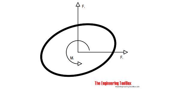

Static equilibrium is achieved when the resultant force and resultant moment equals to zero.
Equilibrium of a body requires both a balance of forces to prevent the body from translating or having accelerated motion along a straight or curved path - and a balance of moments to prevent the body from rotating.
Support reaction forces - equilibrium
Any static force system will be in equilibrium if the resultant force and resultant moment both are equal to zero.
Static equilibrium in a three dimensional system can be expressed as
Σ F = Σ F x = Σ F y = Σ F z = 0                          (1)
Σ M = Σ M x = Σ M y = Σ M z = 0                          (2)
F = force (N, lb)
M = moment (Nm, ft lb)
x, y, z = orthogonal axes
Often the loading of a body can be simplified to a two dimensional system with co-planar forces in the x-y plane.  Eq. 1 and 2 can  be reduced to
Σ F = Σ F x = Σ F y = 0                          (3)
Σ M = Σ M z = 0                          (4)
The best way to account for all forces acting on a body is to draw the body's free-body diagram . A free-body diagram shows the relative magnitude and direction of all forces acting upon an object in a given situation.

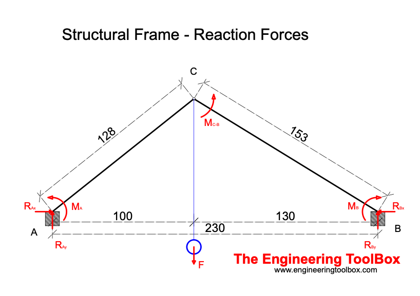

Example - Reaction Forces on a Structural Frame
Reaction forces on a structural frame
A weight F (1000 N) is hanging in a structural frame as shown in the figure above. A structural analyses can be done with the following equations:
∑M A = R By (230 cm)  - (1000 N) (100 cm) = 0                (1)
∑M B = R Ay (230 cm) - (1000 N) (130 cm) = 0                (2)
∑M C-B = R By (130 cm) - R Bx h = 0                (3)
F = R Ay + R By (4)
R Ax = R Bx (5)
Eq. 1 can be rearranged to
R By = (1000 N) (100 cm) / (230 cm)
= 435 N
Eq. 2 can be rearranged to
R Ay = (1000 N) (130 cm) / (230 cm)
= 565 N
The height h in eq. 3 can be calculated as
h = (1532- 1302) 1/2
= 80.7 cm
Eq. 3 can then be rearranged to
R Bx = (435 N) (130 cm) / (80.7 cm)
= 700 N
From eq. 5
R Ax = R Bx
= 700 N
