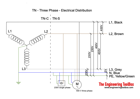

TN
TN 230/400V three phase electrical distribution system
  • 3-Phase, 4-Wire 400Y/230 V
  • used in Europe and others

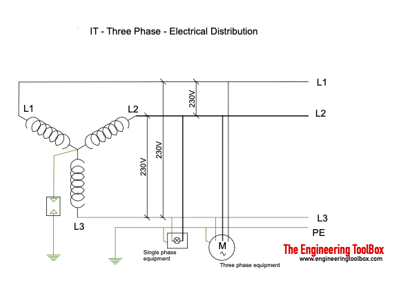

IT
IT 230V three phase electrical distribution system
  • 3-Phase, 3-Wire 230 V Wye (No neutral)
  • used in Norway

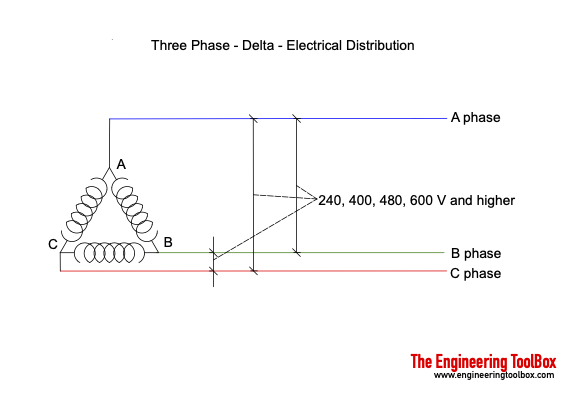

Three Phase Three Wire Delta
three phase delta electrical distribution system
  • used to provide power for three-phase motor loads in industry, and utility power distribution systems
  • voltage typical 240, 400, 480, 600 and higher

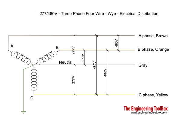

277/480V Three Phase Four Wire Wye
277/480V three phase four wire wye electrical distribution system
  • used in larger US facilities with voltage 277/480. 277 volt is used as single phase for lighting and 480 volt is used for larger loads like HVAC systems
  • in western Canada 347/600V is commonly used

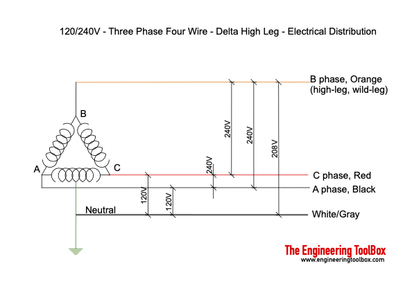

120/240V Three Phase Four Wire Delta
120/240V three phase four wire delta high leg electrical distribution system
  • used in older manufacturing facilities with mostly three-phase motor loads and some 120 volt single-phase lighting and plug loads

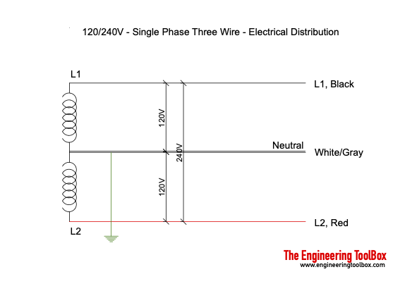

120/240V Single Phase Three Wire
120/240V single phase three wire electrical distribution system
  • grounded neutral system
  • known as the Edison system, split-phase or center-tapped neutral
  • common as residential service in North America

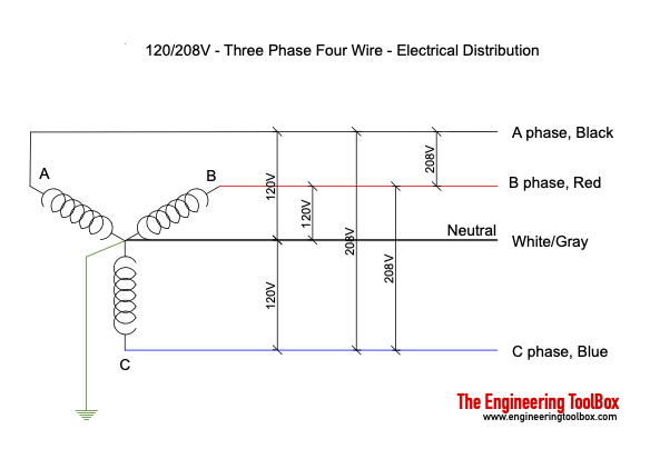

120/208V Three Phase Four Wire Wye
120/208V three phase four wire wye electrical distribution system
  • the most common commercial building electric service in North America
