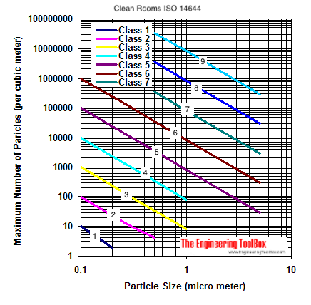

In the clean room standard ISO 14644-1 "Classification of Air Cleanliness" - the classes are based on the equation
Cn = 10N (0.1 / D)2.08                                     (1)
Cn = maximum permitted number of particles per cubic meter equal to or greater than the specified particle size, rounded to whole number
N = ISO class number - must be a multiple of 0.1 and be 9 or less
D = particle size in micrometers
Clean Rooms - Maximum Number of Particles in Air - ISO 14644

clean room particles sizes iso standard diagram
