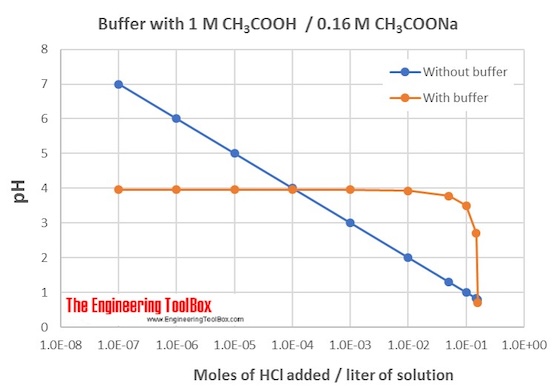

Example 2: To make a buffer solution with a wanted pH
How much of CH3 COOH (ethanoic acid) and NaCH3 COO (sodium ethanoate) do we need to make a buffer solution with pH of 3.95?
The acid equilibrium equation:
CH3 COOH( aq )   ↔    H + ( aq ) +  CH3 COO - ( aq )
K a = [H + ] [CH3 COO - ]/[CH3 COOH]     and    [CH3 COO - ]/[CH3 COOH] = K a /[H + ]
pH = 3.95 corresponds to a concentration [H+] = 10 (-3.95) = 1.12*10-4
pKa for ethanoic acid is 4.76, which gives K a = 10 (-4.76) = 1.74*10 -5
Then, [CH3 COO - ]/[CH3 COOH] = 1.74*10 -5 /1.12*10-4 = 0.16
This means that the concentration of the sodium salt should be 0.16 times of the concentration of the ethanoic acid.
If you start with 1.0 liter of 1 M ethanoic acid, you can add 1 liter of 0.16 M sodium ethanoate. (M = mol/ liter solution)
The figure shows the changes in pH for the buffer solution with addition of HCl:
Buffer solution
Note 1: This can be solved with a number of different concentrations of the two solutions. However, the amounts must be adjusted so that the ratio between the added CH3 COO - and CH3 COOH remains 0.16 in the blend.

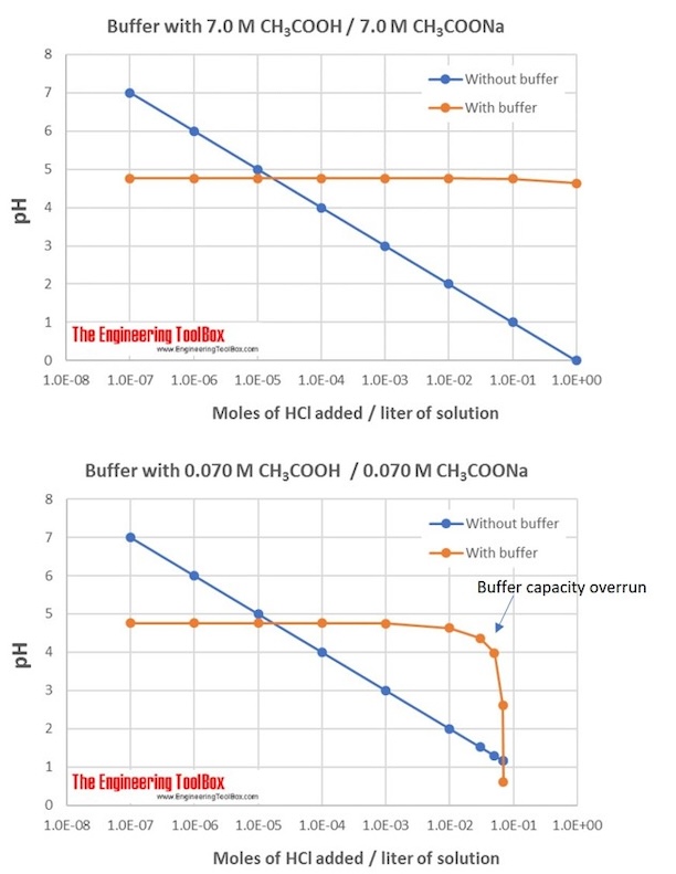

Example 6: Differences in buffer capacity
What will the change in pH be when 0.20 mol gaseous HCl is added to 0.5 liter of each of the two solutions given below?
1. 7.00 M CH3 COOH and 7.00 M CH3 COONa
2. 0.070 M CH3 COOH and 0.070 M CH3 COONa
(M = mol/liter solution)
pK a for ethanoic acid, (CH3 COOH) , is 4.76, which gives K a = 10 (-4.76) = 1.74*10 -5

Solution 1 has a much higher buffer capacity than Solution 2.
The figure shows the differences in buffer capacity for the two solutions:
Buffer capacity
