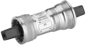

bicycle bottom bracket
Note that the most commonly used bottom bracket thread today is 1 3/8" x 24 TPI.
