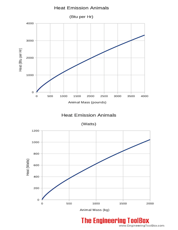

Animals Heat Emission Chart
Heat emissions from animals in relaxed state - imperial and metric units - are indicated in the charts below:
