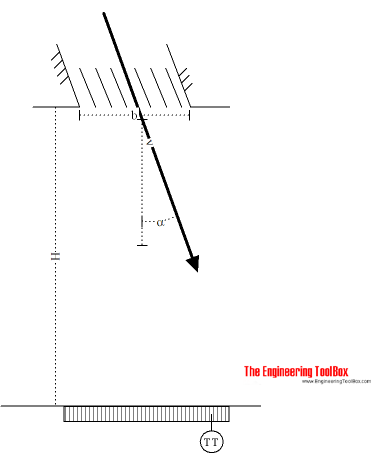

Air Flow and the Potential Differential Pressure
air curtain velocity flow
The "strength" of an air curtain is the maximum potential differential pressure it can resist. The potential pressure resistance generated by an airflow through an inlet opening can be expressed as
Δp = 2.2 q2 sin(α) / b H3/4                                      (1)
Δp = potential differential pressure over the opening in the wall (Pa, N/m2)
q = air flow through discharge nozzle (m3/s per meter opening width in wall)
α = airflow angle (normally between 20 - 30o)
b = depth of discharge nozzle (m)
H = height of door opening (m)
The average air velocity through the discharge nozzle can be calculated as
v = q / b                                                   (2)
v = average velocity (m/s)
Note! The average air velocity is per meter opening width in wall. The velocity should not exceed the values mentioned above.
Air Curtains Calculator
The calculator below can be used to estimate the strength of an air curtain by calculating the pressure difference and velocity in the air flow. Replace the default values with the actual values.
The differential pressure compensates the differential pressure caused by the natural draught and the wind velocity.
Example - Air Curtain
The height of an entrance opening to a shopping-mall is 2.5 m. The depth of the entrance is 1 m. The air flow angle through the entrance is 25 degrees and the air flow per meter width of the opening is 8 m3/s.
The force against natural draught and wind forces can be calculated with (1) as
Δp = 2.2 (8 m3/s)2 sin(25) / 1  (2.5 m)3/4
    = 29.9 Pa
The velocity through the inlet can be calculated with (2) as
v = (8 m3/s) / (1 m)
    = 8 m/s
Modulating Air Curtains
The forces we tries to compensate with air curtains constantly varies with outside temperature and wind velocity and some sort of control device modulating the air flow angle and air flow volume may be required.
  • with outside temperatures close to inside temperatures and lower wind velocities - the air flow in the curtain is minimized and the air flow is directed straight through the doorway
  • with outside temperatures far from inside temperatures - and lots of wind - the air flow in the curtain is maximized and the air flow is directed out of the doorway
A modulated control can be achieved with one or more temperature transmitters located as indicated in the figure above.
