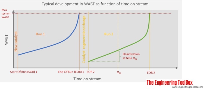

WABT - Weighted Average Bed Temperature is a way to get one representative temperature from an adiabatic reactor (no heat loss or gain to the surroundings), which in reality have an increasing or decreasing temperature profile from inlet to outlet. The temperature profile occurs due to exothermic or endothermic reactions taking place in the reactor. The WABT is used to indicate the catalyst activity in catalytic processes, where a deactivation of the catalyst starts to take place from the start-up after a catalyst change. To maintain the catalyst activity despite the deactivation, the inlet temperature is gradually increased by the operators and the temperature profile through the reactor changes over time. WABT at start of a run is compared to WABT at a given time after start-up, and the difference is telling something about the degree of catalyst deactivation.
WABT_with_TOS

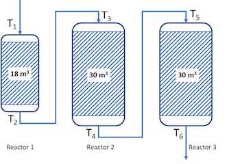

Example 2: Three reactors and Tin and Tout of each reactor
WABT_3_reactors
T1=345°C, T2=380°C, T3=370°C, T4=390°C, T5=385°C and T6=395°C
In this case we have temperature indicators, but we must also know the bulk density of the catalyst beds to do the right weighting of the temperature.
Lets say that the catalyst bulk dencities ρ1= 550 kg/m3, ρ2= 800 kg/m3 and ρ3=750 kg/m3 are for catalyst beds in reactor 1, 2 and 3, respectively. Then, first we calculate weight fraction the total catalyst mass in each reactor:
Catalyst weight in R1: 18 [m3]*550[kg/m3] = 9 900 [kg]
Catalyst weight in R2: 30 [m3]*800[kg/m3] = 24 000 [kg]
Catalyst weight in R3: 30 [m3]*750[kg/m3] = 22 500 [kg]
Total catalyst weight: 56 400 [kg]
WcR1 = 9900/56400 = 0.18
WcR2 = 24000/56400 = 0.42
WcR3 = 22500/56400 = 0.40
Then, we can calculate the WABT:
WABT = WABTR1*WcR1 + WABTR2*WcR2 + WABTR3*WcR3
        = (T1+2T2)/3*0.18 + (T3+2T4)/3*0.42 + (T5+2T6)/3*0.40
        = (345 + 2*380)/3*0.18 + (370 + 2*390)/3*0.42 + (385 + 2*395)/3*0.40  = 384°C

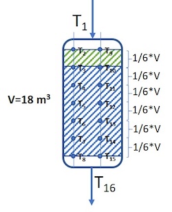

Example 3: One reactor with two chains of thermocouples throughout the reactor
WABT_1_reactor
T1=351°C, T2=350°C, T3=368°C, T4=386°C, T5=399°C, T6=406°C, T7=411°C, T8=413°C, T9=350°C, T10=370°C, T11=387°C, T12=398°C, T13=405°C, T14=410°C, T15=412°C and T16=411°C
In this case there is a 1/6 top layer of catalyst, with density ρ1= 550 kg/m3, while the rest of the catalyst mass (5/6) has density ρ2= 800 kg/m3. Then the catalyst weight fractions for each of the fractions of the catalyst bed will be:
Catalyst weight top layer: 18*1/6 [m3] * 550 [kg/m3] = 1 650 [kg]
Catalyst weight layer 2 to 6: 18*1/6 [m3] * 800 [kg/m3] = 2 400 [kg]
Total catalyst weight: 1 650 [kg] + 2 400[kg]*5 = 13 650 [kg]
Wc1 = 1650/13650= 0.12
Wc2 = Wc3 = Wc4 = Wc5 = Wc6 = 2400/13650 = 0.176
WABT = WABT1*Wc1 + WABT2*Wc2 + WABT3*Wc3 + WABT4*Wc4 + WABT5*Wc5 + WABT6*Wc6
           = WABT1*Wc1 + Wc2*(WABT2 + WABT3 + WABT4 + WABT5 + WABT6)
In this case, there are two thermocouples at each height level in the reactor, and Tin and Tout of each fraction is the average of these two. Then, WABT is:
WABT = ((T2+T9)/2+2*(T3+T10)/2)/3*0.12 + 0.176*(((T3+T10)/2+2*(T4+T11)/2)/3 + ((T4+T11)/2+2*(T5+T12)/2)/3 + ((T5+T12)/2+2*(T6+T13)/2)/3 + ((T6+T13)/2+2*(T7+T14)/2)/3 + ((T7+T14)/2+2*(T8+T15)/2)/3)
          = ((350+350)/2+2*(368+370)/2)/3*0.12 + 0.176*(((368+370)/2+2*(386+387)/2)/3 + ((386+387)/2+2*(399+398)/2)/3 + ((399+398)/2+2*(406+405)/2)/3 + ((406+405)/2+2*(411+410)/2)/3 + ((411+410)/2+2*(413+412)/2)/3  = 395.3°C
It should be obvious that this is a more precise measurement/calculation than the more simple
WABT = (T1 + 2*T16)/3 * 1
          = (351 + 2*411)/3*1 = 391.0 °C

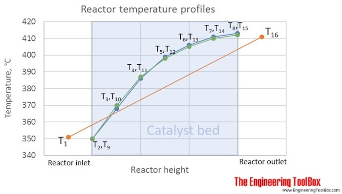

reactor_temperature_profile
The figure above shows the given temperature profile, which is typical for a gas oil hydrotreater in a refinery. Calculating WABT from T1 and T16, only, gives 391°C, while using the catalyst bed temperatures, measured by T2 to T15, gives WABT = 395°C. If calculating the average bed temperature, simply as the average of T1 and T16, you get 381°C, which is much less representative for the temperature in the catalyst bed than the WABT using the same temperatures.
The reason for the actual shape given in this figure, is that the fastest reactions, in this case, are the most exothermic (giving a fast temperature increase at the reactor inlet), and when their potential is used up (reach equilibrium or reactants are consumed), more slow, and less exothermic reactions take place.
