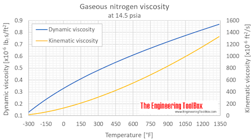

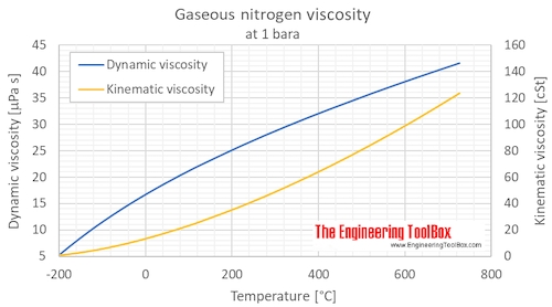

Nitrogen dynamic and kinematic viscosity at atmospheric pressure and varying temperature:
Nitrogene viscosity 1 bara C Nitrogene viscosity 1 bara F

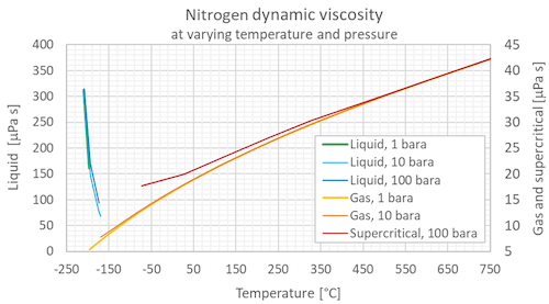

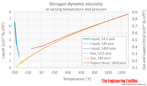

Dynamic viscosity of nitrogen at varying temperature and 1, 10 and 100 bara (14.5, 145 and 1450 psia):
Nitrogene dynamic viscosity pressure C
Nitrogene dynamic viscosity pressure F

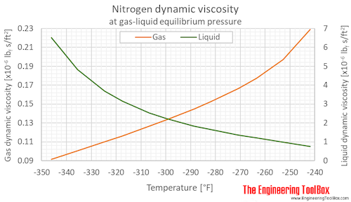

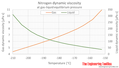

Dynamic viscosity at gas-liquid equilibrium pressure: Nitrogene dynamic viscosity equilibrium C
Nitrogene dynamic viscosity equilibrium F

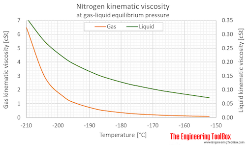

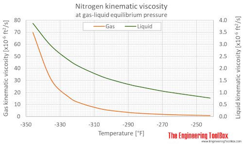

Kinematic viscosity at gas-liquid equilibrium pressure:
Nitrogen kinematic viscosity equilibrium C
Nitrogen kinematic viscosity equilibrium F

State Temperature Pressure < Dynamic (Absolute) Viscosity Kinematic Viscosity
[K] [°C] [°F] [MPa] [bara] [μPa s] [cP] [lbf s/ft2*10-6 ] [lbm /ft s*10-6 ] [lbm /ft h] [cSt],
[m2/s*10-6 ]
[ft2/s*10-6 ]
Liquid at
equilibrium
63.15 -210.0 -346.0 0.013 0.125 311.6 0.3116 6.508 209.4 0.7538 0.3593 3.867
69 -204 -335 0.033 0.332 230.9 0.2309 4.821 155.1 0.5584 0.2739 2.948
75 -198 -325 0.076 0.760 176.8 0.1768 3.692 118.8 0.4276 0.2164 2.330
79 -194 -317 0.122 1.22 150.7 0.1507 3.148 101.3 0.3646 0.1887 2.031
85 -188 -307 0.229 2.29 121.3 0.1213 2.534 81.52 0.2935 0.1575 1.695
89 -184 -299 0.331 3.31 106.2 0.1062 2.218 71.35 0.2569 0.1415 1.524
95 -178 -289 0.541 5.41 88.00 0.08800 1.838 59.14 0.2129 0.1225 1.319
99 -174 -281 0.726 7.26 78.42 0.07842 1.638 52.70 0.1897 0.1128 1.214
105 -168 -271 1.08 10.8 65.29 0.06529 1.364 43.87 0.1579 0.0993 1.069
109 -164 -263 1.38 13.8 57.79 0.05779 1.207 38.83 0.1398 0.09185 0.9887
115 -158 -253 1.94 19.4 47.29 0.04729 0.9877 31.78 0.1144 0.08172 0.8796
121 -152 -242 2.64 26.4 36.51 0.03651 0.7625 24.53 0.08832 0.07166 0.7713
Gas at
equilibrium
63.15 -210.0 -346.0 0.013 0.125 4.376 0.00438 0.0914 2.941 0.01059 6.490 69.86
69 -204 -335 0.033 0.332 4.809 0.00481 0.1004 3.231 0.01163 2.908 31.30
75 -198 -325 0.076 0.760 5.262 0.00526 0.1099 3.536 0.01273 1.486 16.00
79 -194 -317 0.122 1.22 5.573 0.00557 0.1164 3.745 0.01348 1.014 10.92
85 -188 -307 0.229 2.29 6.057 0.00606 0.1265 4.070 0.01465 0.6165 6.636
89 -184 -299 0.331 3.31 6.395 0.00639 0.1336 4.297 0.01547 0.4604 4.956
95 -178 -289 0.541 5.41 6.935 0.00694 0.1448 4.660 0.01678 0.3114 3.352
99 -174 -281 0.726 7.26 7.326 0.00733 0.1530 4.923 0.01772 0.2459 2.647
105 -168 -271 1.08 10.8 7.980 0.00798 0.1667 5.363 0.01931 0.1775 1.911
109 -164 -263 1.38 13.8 8.487 0.00849 0.1772 5.703 0.02053 0.1448 1.559
115 -158 -253 1.94 19.4 9.440 0.00944 0.1971 6.343 0.02283 0.1081 1.164
121 -152 -242 2.64 26.4 10.95 0.01095 0.2288 7.360 0.02650 0.08082 0.8699
Liquid 63.17 -210.0 -346.0 0.1 1 311.6 0.3116 6.508 209.4 0.7538 0.3593 3.867
77.24 -195.9 -320.6 0.1 1 161.4 0.1614 3.371 108.5 0.3904 0.2001 2.154
77.24 -195.9 -320.6 0.1 1 5.435 0.00544 0.1135 3.652 0.01315 1.193 12.84
Gas 80 -193.2 -315.7 0.1 1 5.623 0.00562 0.1174 3.778 0.01360 1.284 13.82
100 -173.2 -279.7 0.1 1 6.958 0.00696 0.1453 4.676 0.01683 2.024 21.79
120 -153.2 -243.7 0.1 1 8.244 0.00824 0.1722 5.540 0.01994 2.903 31.25
140 -133.2 -207.7 0.1 1 9.480 0.00948 0.1980 6.370 0.02293 3.911 42.10
160 -113.2 -171.7 0.1 1 10.67 0.01067 0.2228 7.170 0.02581 5.043 54.28
180 -93.2 -135.7 0.1 1 11.81 0.01181 0.2467 7.936 0.02857 6.289 67.69
200 -73.2 -99.7 0.1 1 12.91 0.01291 0.2696 8.675 0.03123 7.648 82.32
220 -53.2 -63.7 0.1 1 13.97 0.01397 0.2918 9.387 0.03379 9.107 98.03
240 -33.2 -27.7 0.1 1 15.00 0.01500 0.3133 10.08 0.03629 10.68 114.9
260 -13.2 8.3 0.1 1 15.99 0.01599 0.3340 10.74 0.03868 12.33 132.7
280 6.9 44.3 0.1 1 16.96 0.01696 0.3542 11.40 0.04103 14.09 151.6
300 26.9 80.3 0.1 1 17.89 0.01789 0.3736 12.02 0.04328 15.93 171.5
320 46.9 116.3 0.1 1 18.80 0.01880 0.3926 12.63 0.04548 17.85 192.2
340 66.9 152.3 0.1 1 19.68 0.01968 0.4110 13.22 0.04761 19.86 213.8
360 86.9 188.3 0.1 1 20.55 0.02055 0.4292 13.81 0.04971 21.96 236.4
400 126.9 260.3 0.1 1 22.21 0.02221 0.4639 14.92 0.05373 26.37 283.9
500 226.9 440.3 0.1 1 26.06 0.02606 0.5443 17.51 0.06304 38.69 416.4
600 326.9 620.3 0.1 1 29.58 0.02958 0.6178 19.88 0.07156 52.70 567.2
700 426.9 800.3 0.1 1 32.83 0.03283 0.6857 22.06 0.07942 68.24 734.5
800 526.9 980.3 0.1 1 35.89 0.03589 0.7496 24.12 0.08682 85.25 917.6
900 626.9 1160.3 0.1 1 38.78 0.03878 0.8099 26.06 0.09381 103.63 1115.5
1000 726.9 1340.3 0.1 1 41.54 0.04154 0.8676 27.91 0.1005 123.34 1327.6
Liquid 63.37 -210 -346 1 10 311.8 0.3118 6.512 209.5 0.7543 0.3592 3.867
80 -193 -316 1 10 147.3 0.1473 3.076 98.98 0.3563 0.1850 1.991
100 -173 -280 1 10 76.26 0.07626 1.593 51.24 0.1845 0.1104 1.188
103.8 -169.4 -272.9 1 10 67.78 0.06778 1.416 45.55 0.1640 0.1018 1.096
Gas 103.8 -169.4 -272.9 1 10 7.835 0.00784 0.1636 5.265 0.01895 0.1896 2.040
140.0 -133.2 -207.7 1 10 9.844 0.00984 0.2056 6.615 0.02381 0.3785 4.074
160 -113 -172 1 10 10.96 0.01096 0.2289 7.365 0.02651 0.4957 5.336
180 -93 -136 1 10 12.06 0.01206 0.2519 8.104 0.02917 0.6239 6.716
200 -73.2 -99.7 1 10 13.13 0.01313 0.2742 8.823 0.03176 0.7629 8.212
240 -33.2 -27.7 1 10 15.17 0.01517 0.3168 10.19 0.03670 1.071 11.52
300 26.9 80.3 1 10 18.01 0.01801 0.3761 12.10 0.04357 1.604 17.27
400 127 260 1 10 22.29 0.02229 0.4655 14.98 0.05392 2.647 28.49
500 227 440 1 10 26.13 0.02613 0.5457 17.56 0.06321 3.879 41.75
600 327 620 1 10 29.63 0.02963 0.6188 19.91 0.07167 5.298 57.0
800 527 980 1 10 35.92 0.03592 0.7502 24.14 0.08689 8.532 91.84
1100 827 1520 1 10 44.22 0.04422 0.9236 29.72 0.1070 14.48 155.9
1600 1327 2420 1 10 56.41 0.05641 1.178 37.91 0.1365 26.85 289.0
Liquid 100 -173 -280 5 50 84.51 0.08451 1.765 56.79 0.2044 0.1186 1.277
Supercritical
phase
600 327 620 5 50 29.88 0.02988 0.6241 20.08 0.07229 1.088 11.71
1100 827 1520 5 50 44.33 0.04433 0.9259 29.79 0.1072 2.941 31.66
1600 1327 2420 5 50 56.48 0.05648 1.180 37.95 0.1366 5.427 58.42
Liquid 65.32 -208 -342 10 100 314.0 0.3140 6.558 211.0 0.7596 0.3589 3.863
80 -193 -316 10 100 169.0 0.1690 3.530 113.6 0.4088 0.2065 2.223
100 -173 -280 10 100 93.65 0.09365 1.956 62.93 0.2265 0.1277 1.374
Supercritical
phase
200 -73.2 -99.7 10 100 17.70 0.01770 0.3697 11.89 0.04282 0.09 0.9555
300 26.9 80.3 10 100 19.96 0.01996 0.4169 13.41 0.04829 0.1787 1.923
400 127 260 10 100 23.51 0.02351 0.4910 15.80 0.05687 0.2896 3.117
500 227 440 10 100 26.99 0.02699 0.5637 18.14 0.06529 0.4184 4.504
600 327 620 10 100 30.28 0.03028 0.6325 20.35 0.07326 0.5635 6.066
1100 827 1520 10 100 44.49 0.04449 0.9293 29.90 0.1076 1.500 16.14
1600 1327 2420 10 100 56.48 0.05648 1.180 37.95 0.1366 2.745 29.55
