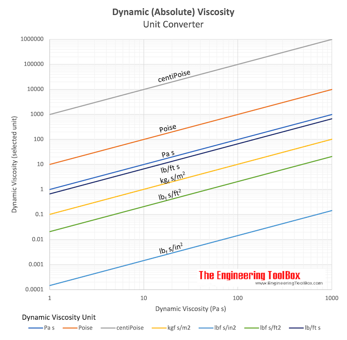

Dynamic Viscosity Unit Converter chart
Download and print Dynamic Viscosity Unit Converter chart
