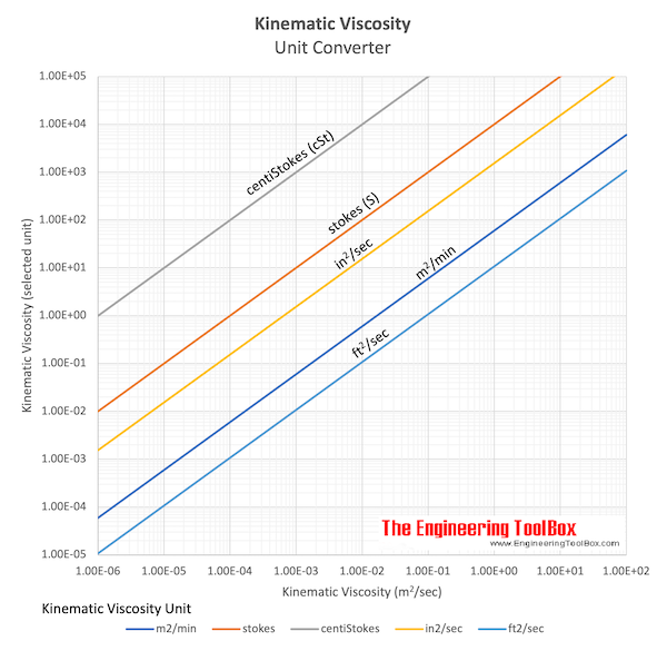

Kinematic viscosity units converting chart
Download and print Kinematic Viscosity Unit Converting Chart
