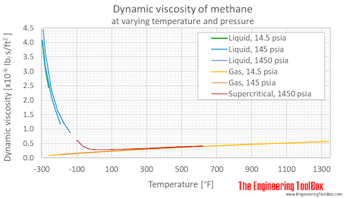

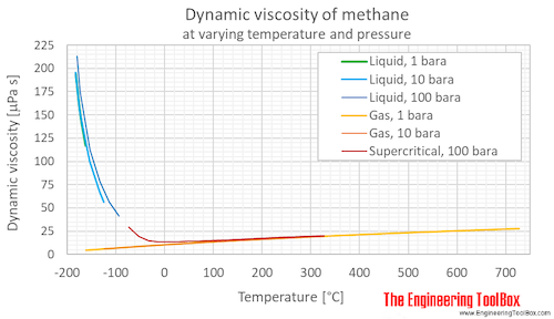

Dynamic viscosity of methane at varying temperature and 1, 10 and 100 bara (14.5, 145 and 1450 psia):
Methane dynemic viscosity pressure C
Methane dynemic viscosity pressure F

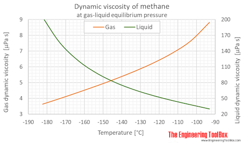

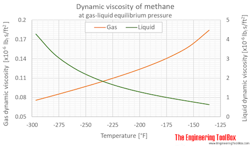

Dynamic viscosity of methane at gas-liquid equilibrium pressure: Methane dynamic viscosity equilibrium C
Methane dynamic viscosity equilibrium F

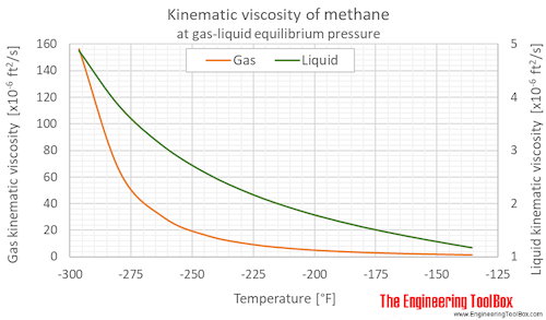

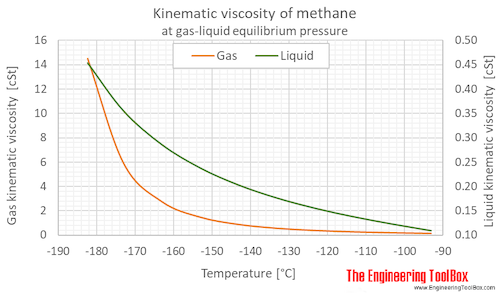

Kinematic viscosity of methane at gas-liquid equilibrium pressure:
Methane kinematic viscosity equilibrium C
Methane kinematic viscosity equilibrium F
