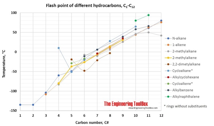

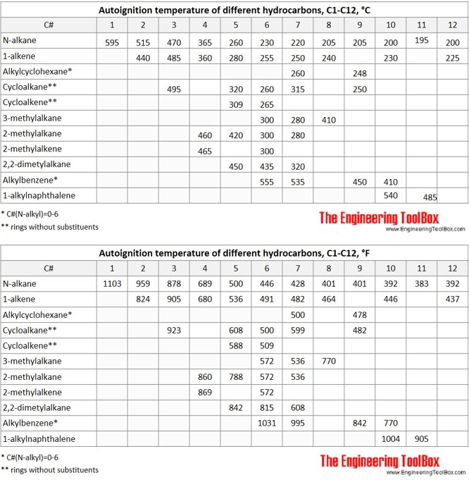

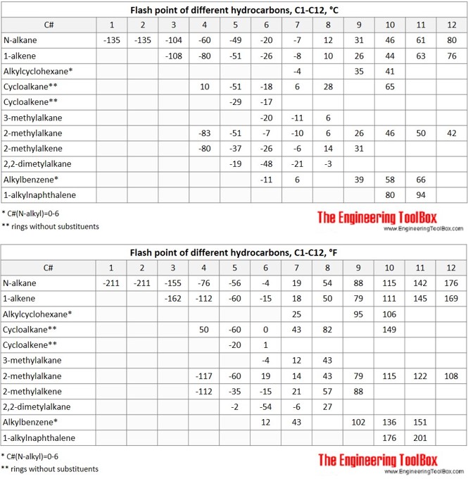

The tables and figures below show the autoignition temperature (AIT) and flash point (FP) for different hydrocarbons. In the figures, the AIT and FP are shown as function of number of carbon atoms in the hydrocarbons, which are grouped as n-alkanes, 1-alkenes, 2-methylalkanes, 3-methylalkanes, 2,2,dimethylalkanes, 2-methylalkenes, cycloalkanes, alkylcyclohexanes, cycloalkenes, alkylbenzenes and alkylnaphthalenes.

  • Values of autoignition temperature are generally higher than flash point, as given for pure hydrocarbons in the tables and figures below.
  • With an increase in pressure the autoignition temperature decreases. This is particularly important from a safety point of view when hydrocarbons are compressed.
  • Hydrocarbons with high vapor pressures (lighter compounds) have low flash points. Generally, flash point increases with an increase in boiling point.

Flash point figure

Autoignition temperature table
Flash point table
