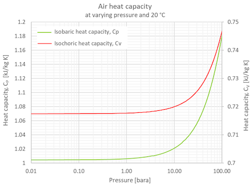

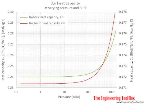

Specific Heat of dry air at constant temperature 20 oC / 68°F at various pressures:

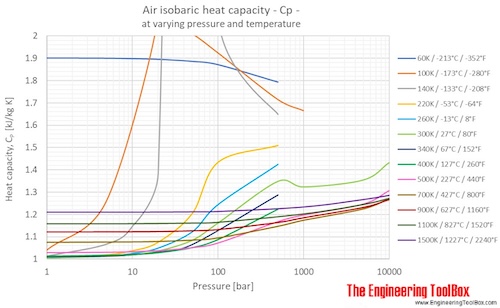

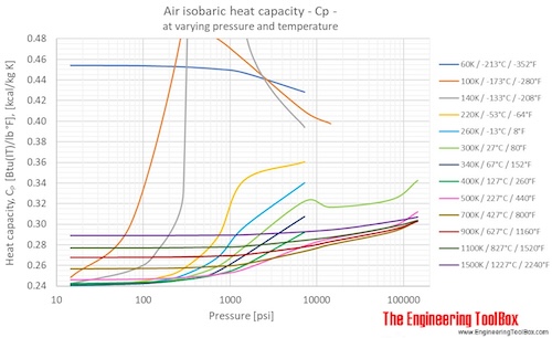

Specific Heat of dry air at selected temperatures at various pressures:
