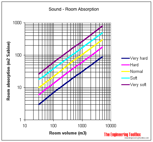

The mean sound absorption coefficient should be calculated when more accurate values are needed.
The diagram below can be used to determine the sound absorption in rooms of different sizes and with different accoustic characteristics.
Sound Room Absorption
