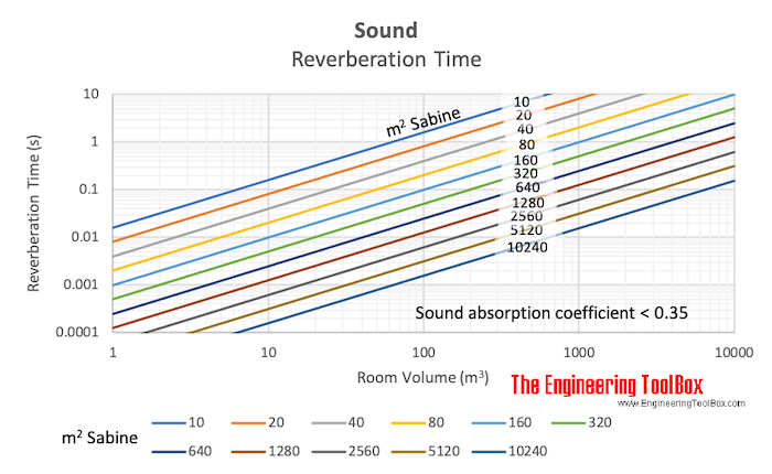

The Reverberation Time - Ta - for a room is the time it takes before the sound pressure level has decreased with 60 dB after the sound source is terminated and can be calculated as
Mean sound absorption coefficient αm <= 0.35:
Ta = 0.16 V / A                     (1)
Ta = reverberation time (s)
V = room volume (m3)
A = the total sound absorption of the room (m2 Sabine)
Sound reverberation time vs. room volume and sound absorption Sabine

Mean sound absorption coefficient αm > 0.35:
Ta = 0.16 V / [(A /αm)ln (1 / (1 - αm))]                       (2)
Note! The sound absorption of the room - A - vary with sound frequency, and so do the reverberation time - Ta.
