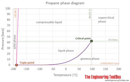

The phase diagram for propane shows the phase behavior with changes in temperature and pressure. The curve between the critical point and the triple point shows the propane boiling point with changes in pressure. It also shows the saturation pressure with changes in temperature.
Propane phase diagram
