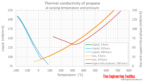

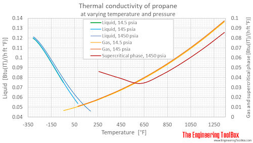

The thermal conductivity of propane depends on temperature and pressure as shown in the figures and tables below.

Propane thermal conductivity Pressure C
Propane thermal conductivity Pressure F
