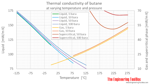

The thermal conductivity of butane depends on temperature and pressure as shown in the figures and tables below.

Thermal conductivity of butane at given temperatures (°C and °F) and 1 bara:
State | Temperature | Thermal conductivity | Temperature | Thermal conductivity | |||||
[K] | [°C] | [mW/m K] | [kcal(IT)/(h m K)] | [K] | [°F] | [Btu(IT)/(h ft °F)] | [kcal(IT)/(h m K)] | ||
Liquid | 78.2 | -195 | 192.1 | 0.1652 | 77.6 | -320 | 0.1110 | 0.1653 | |
123 | -150 | 180.9 | 0.1556 | 116 | -250 | 0.1057 | 0.1574 | ||
148 | -125 | 171.9 | 0.1478 | 144 | -200 | 0.1002 | 0.1491 | ||
173 | -100 | 161.6 | 0.1389 | 172 | -150 | 0.09363 | 0.1393 | ||
198 | -75 | 150.3 | 0.1292 | 200 | -100 | 0.08637 | 0.1285 | ||
223 | -50 | 138.5 | 0.1191 | 228 | -50 | 0.07879 | 0.1173 | ||
231 | -42 | 134.7 | 0.1158 | 231 | -44 | 0.07788 | 0.1159 | ||
248 | -25 | 126.7 | 0.1089 | 244 | -20 | 0.07424 | 0.1105 | ||
263 | -10 | 119.8 | 0.1030 | 255 | 0 | 0.07126 | 0.1060 | ||
268 | -5 | 117.5 | 0.1011 | 266 | 20 | 0.06834 | 0.1017 | ||
272.3 | -0.84 | 115.7 | 0.09947 | 272.3 | 30.49 | 0.06684 | 0.09947 | ||
Gas | 272.3 | -0.84 | 14.11 | 0.01214 | 272.3 | 30.49 | 0.00815 | 0.01214 | |
283 | 10 | 15.12 | 0.01300 | 283 | 50 | 0.00873 | 0.01300 | ||
293 | 20 | 16.07 | 0.01382 | 300 | 80 | 0.00967 | 0.01438 | ||
303 | 30 | 17.06 | 0.01467 | 305 | 90 | 0.00999 | 0.01486 | ||
323 | 50 | 19.13 | 0.01645 | 311 | 100 | 0.01032 | 0.01535 | ||
348 | 75 | 21.90 | 0.01883 | 339 | 150 | 0.01204 | 0.01791 | ||
373 | 100 | 24.87 | 0.02138 | 366 | 200 | 0.01390 | 0.02069 | ||
398 | 125 | 28.03 | 0.02410 | 394 | 250 | 0.01591 | 0.02367 | ||
423 | 150 | 31.40 | 0.02700 | 422 | 300 | 0.01805 | 0.02686 | ||
448 | 175 | 34.96 | 0.03006 | 478 | 400 | 0.02277 | 0.03389 | ||
473 | 200 | 38.72 | 0.03329 | 533 | 500 | 0.02806 | 0.04176 | ||
523 | 250 | 46.84 | 0.04028 | 589 | 600 | 0.03392 | 0.05047 | ||
573 | 300 | 55.76 | 0.04795 | 644 | 700 | 0.04034 | 0.06004 | ||
623 | 350 | 65.48 | 0.05630 | 700 | 800 | 0.04734 | 0.07045 | ||
673 | 400 | 76.00 | 0.06535 | 755 | 900 | 0.05491 | 0.08171 | ||
773 | 500 | 99.42 | 0.08549 | 811 | 1000 | 0.06303 | 0.09380 |
Thermal conductivity of butane at given temperatures and pressures, SI and Imperial units:
State | Temperature | Pressure | Thermal conductivity | |||||
[K] | [°C] | [°F] | [bara] | [psia] | [mW/m K] | [kcal(IT)/(h m K)] | [Btu(IT)/(h ft °F)] | |
Liquid at equilibrium | 134.9 | -138.25 | -216.85 | 6.7E-06 | 9.7E-05 | 176.6 | 0.1518 | 0.1020 |
150 | -123 | -190 | 8.6E-05 | 1.2E-03 | 171.2 | 0.1472 | 0.09892 | |
200 | -73 | -100 | 0.0194 | 0.281 | 149.4 | 0.1285 | 0.08632 | |
220 | -53 | -64 | 0.0781 | 1.13 | 139.9 | 0.1203 | 0.08083 | |
240 | -33.2 | -28 | 0.241 | 3.49 | 130.4 | 0.1121 | 0.07534 | |
260 | -13.2 | 8.3 | 0.610 | 8.84 | 121.2 | 0.1042 | 0.07003 | |
280 | 6.9 | 44.3 | 1.33 | 19.3 | 112.3 | 0.09656 | 0.06489 | |
300 | 26.9 | 80.3 | 2.58 | 37.4 | 103.9 | 0.08934 | 0.06003 | |
320 | 46.9 | 116 | 4.56 | 66.2 | 96.10 | 0.08263 | 0.05553 | |
340 | 66.9 | 152 | 7.52 | 109 | 88.88 | 0.07642 | 0.05135 | |
360 | 86.9 | 188 | 11.7 | 170 | 82.27 | 0.07074 | 0.04753 | |
380 | 106.9 | 224 | 17.4 | 252 | 76.22 | 0.06554 | 0.04404 | |
400 | 126.9 | 260 | 25.0 | 362 | 70.60 | 0.06071 | 0.04079 | |
420 | 146.9 | 296 | 34.9 | 506 | 67.19 | 0.05777 | 0.03882 | |
134.9 | -138.25 | -216.85 | 6.7E-06 | 9.7E-05 | 4.855 | 0.00417 | 0.00281 | |
Gas at equilibrium | 150 | -123 | -190 | 8.6E-05 | 1.2E-03 | 5.579 | 0.00480 | 0.00322 |
200 | -73 | -100 | 0.0194 | 0.281 | 8.497 | 0.00731 | 0.00491 | |
220 | -53 | -64 | 0.0781 | 1.13 | 9.884 | 0.00850 | 0.00571 | |
240 | -33.2 | -28 | 0.241 | 3.49 | 11.39 | 0.00979 | 0.00658 | |
260 | -13.2 | 8.3 | 0.610 | 8.84 | 13.03 | 0.01120 | 0.00753 | |
280 | 6.9 | 44.3 | 1.33 | 19.3 | 14.82 | 0.01274 | 0.00856 | |
300 | 26.9 | 80.3 | 2.58 | 37.4 | 16.78 | 0.01443 | 0.00970 | |
320 | 46.9 | 116 | 4.56 | 66.2 | 19.00 | 0.01634 | 0.01098 | |
340 | 66.9 | 152 | 7.52 | 109 | 21.58 | 0.01856 | 0.01247 | |
360 | 86.9 | 188 | 11.7 | 170 | 24.72 | 0.02126 | 0.01428 | |
380 | 107 | 224 | 17.4 | 252 | 28.81 | 0.02477 | 0.01665 | |
400 | 127 | 260 | 25.0 | 362 | 35.03 | 0.03012 | 0.02024 | |
420 | 147 | 296 | 34.9 | 506 | 53.10 | 0.04566 | 0.03068 | |
Liquid | 150 | -123 | -190 | 1 | 14.5 | 171.2 | 0.1472 | 0.09893 |
200 | -73.2 | -100 | 1 | 14.5 | 149.4 | 0.1285 | 0.08632 | |
250 | -23.2 | -9.7 | 1 | 14.5 | 125.8 | 0.1082 | 0.07269 | |
272.31 | -0.84 | 30.49 | 1 | 14.5 | 115.7 | 0.09947 | 0.06684 | |
Gas | 272.31 | -0.84 | 30.49 | 1 | 14.5 | 14.11 | 0.01213 | 0.00815 |
300 | 26.9 | 80.3 | 1 | 14.5 | 16.75 | 0.01440 | 0.00968 | |
350 | 76.9 | 170 | 1 | 14.5 | 22.12 | 0.01902 | 0.01278 | |
400 | 127 | 260 | 1 | 14.5 | 28.28 | 0.02431 | 0.01634 | |
450 | 177 | 350 | 1 | 14.5 | 35.23 | 0.03029 | 0.02036 | |
500 | 227 | 440 | 1 | 14.5 | 42.98 | 0.03696 | 0.02483 | |
550 | 277 | 530 | 1 | 14.5 | 51.53 | 0.04431 | 0.02978 | |
Liquid | 150 | -123 | -190 | 10 | 145 | 171.5 | 0.1474 | 0.09908 |
200 | -73.2 | -100 | 10 | 145 | 149.8 | 0.1288 | 0.08655 | |
250 | -23.2 | -9.7 | 10 | 145 | 126.3 | 0.1086 | 0.07300 | |
300 | 26.9 | 80.3 | 10 | 145 | 104.5 | 0.08986 | 0.06038 | |
350 | 76.9 | 170 | 10 | 145 | 85.56 | 0.07357 | 0.04944 | |
352.62 | 79.47 | 175.05 | 10 | 145 | 84.64 | 0.07277 | 0.04890 | |
Gas | 352.62 | 79.47 | 175.05 | 10 | 145 | 23.47 | 0.02018 | 0.01356 |
400 | 127 | 260 | 10 | 145 | 29.23 | 0.02513 | 0.01689 | |
450 | 177 | 350 | 10 | 145 | 36.24 | 0.03116 | 0.02094 | |
500 | 227 | 440 | 10 | 145 | 44.07 | 0.03789 | 0.02546 | |
550 | 277 | 530 | 10 | 145 | 52.70 | 0.04532 | 0.03045 | |
Liquid | 150 | -123 | -190 | 50 | 725 | 172.6 | 0.1484 | 0.09974 |
200 | -73.2 | -100 | 50 | 725 | 151.5 | 0.1303 | 0.08755 | |
250 | -23.2 | -9.7 | 50 | 725 | 128.6 | 0.1106 | 0.07433 | |
300 | 26.9 | 80.3 | 50 | 725 | 107.5 | 0.09243 | 0.06211 | |
350 | 76.9 | 170 | 50 | 725 | 89.62 | 0.07706 | 0.05178 | |
400 | 127 | 260 | 50 | 725 | 75.04 | 0.06452 | 0.04335 | |
Supercritical phase |
450 | 177 | 350 | 50 | 725 | 55.86 | 0.04803 | 0.03228 |
500 | 227 | 440 | 50 | 725 | 51.14 | 0.04397 | 0.02955 | |
550 | 277 | 530 | 50 | 725 | 57.84 | 0.04973 | 0.03342 | |
Liquid | 150 | -123 | -190 | 100 | 1450 | 174.0 | 0.1496 | 0.1006 |
200 | -73.2 | -100 | 100 | 1450 | 153.6 | 0.1321 | 0.08875 | |
250 | -23.2 | -9.7 | 100 | 1450 | 131.4 | 0.1130 | 0.07592 | |
300 | 26.9 | 80.3 | 100 | 1450 | 111.0 | 0.09543 | 0.06413 | |
350 | 76.9 | 170 | 100 | 1450 | 94.02 | 0.08084 | 0.05432 | |
400 | 127 | 260 | 100 | 1450 | 81.08 | 0.06972 | 0.04685 | |
450 | 177 | 350 | 100 | 1450 | 71.91 | 0.06183 | 0.04155 |
500 | 227 | 440 | 100 | 1450 | 65.91 | 0.05667 | 0.03808 | |
550 | 277 | 530 | 100 | 1450 | 65.62 | 0.05642 | 0.03791 | |
Liquid | 150 | -123 | -190 | 300 | 4351 | 179.3 | 0.1542 | 0.1036 |
200 | -73.2 | -100 | 300 | 4351 | 161.4 | 0.1388 | 0.09324 | |
250 | -23.2 | -9.7 | 300 | 4351 | 141.4 | 0.1216 | 0.08172 | |
300 | 26.9 | 80.3 | 300 | 4351 | 123.1 | 0.1058 | 0.07112 | |
350 | 76.9 | 170 | 300 | 4351 | 108.1 | 0.09292 | 0.06244 | |
400 | 127 | 260 | 300 | 4351 | 97.05 | 0.08345 | 0.05608 | |
450 | 177 | 350 | 300 | 4351 | 90.03 | 0.07741 | 0.05202 |
500 | 227 | 440 | 300 | 4351 | 86.54 | 0.07441 | 0.05000 | |
550 | 277 | 530 | 300 | 4351 | 85.90 | 0.07386 | 0.04963 | |
Liquid | 150 | -123 | -190 | 650 | 9427 | 187.4 | 0.1612 | 0.1083 |
200 | -73.2 | -100 | 650 | 9427 | 173.2 | 0.1489 | 0.1001 | |
250 | -23.2 | -9.7 | 650 | 9427 | 156.3 | 0.1344 | 0.09033 | |
300 | 26.9 | 80.3 | 650 | 9427 | 140.3 | 0.1207 | 0.08109 | |
350 | 76.9 | 170 | 650 | 9427 | 127.0 | 0.1092 | 0.07336 | |
400 | 127 | 260 | 650 | 9427 | 116.9 | 0.1005 | 0.06754 | |
450 | 177 | 350 | 650 | 9427 | 110.2 | 0.09474 | 0.06366 |
500 | 227 | 440 | 650 | 9427 | 106.6 | 0.09162 | 0.06156 | |
550 | 277 | 530 | 650 | 9427 | 105.6 | 0.09079 | 0.06101 |
