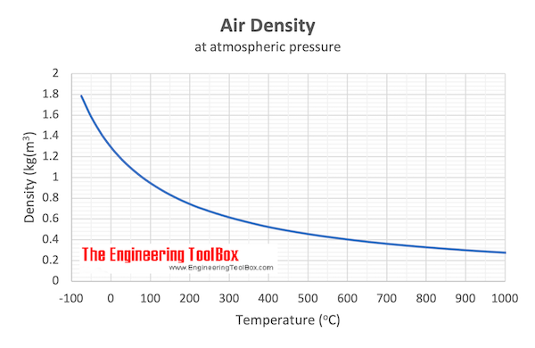

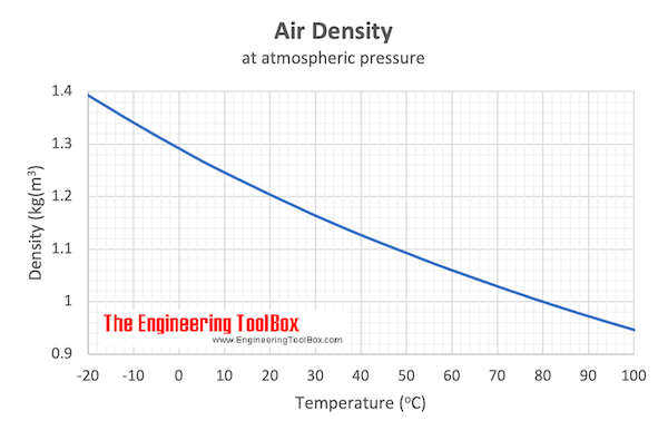

Download and print Air - Density vs. Temperature Chart
Example - Mass of Air at Temperature 100 oC
From the table above - the density of air is 0.946 kg/m3 at 100 oC . The mass of 10 m 3 air can be calculated as
m = V ρ
= (10 m3 ) (0.946 kg/m3 )
= 9.46 kg
m = mass (kg)
V = volume (m3 )
ρ = density (kg/m3 )
Example - Mass of Air at Temperature 20 oC
From the table above - the density of air is 1.205 kg/m3 at 20 oC . The mass of 10 m 3 air can be calculated as
m = (10 m3 ) (1.205 kg/m3 )
= 12.05 kg
