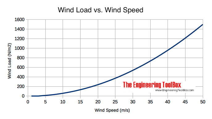

When moving air - wind - is stopped by a surface - the dynamic energy in the wind is transformed to pressure. The pressure acting the surface transforms to a force
Fw = pd A
     = 1/2 ρ v2 A                               (1)
Fw = wind force (N)
A = surface area (m2)
pd = dynamic pressure  (Pa)
ρ = density of air (kg/m3)
v = wind speed (m/s)
Note - in practice wind force acting on a object creates more complex forces due to drag and other effects.

Example - Hurricane Wind Load acting on a Wall Surface
A hurricane with wind speed 35 m/s is acting on a 10 m2 wall. The dynamic force can be calculated as
Fw = 1/2 ρ v2 A
    = 1/2 (1.2 kg/m3) (35 m/s)2 (10 m2)
    = 7350 N
    = 7.35 kN
Or - from the table above the wind load per square metre is 735 N/m2. The total load on the wall can be calculated as
(735 N/m2) (10 m2) = 7350 N
A hurricane acting on a 10 m2 wall creates a force equal to the weight of aprox. 750 kg.
