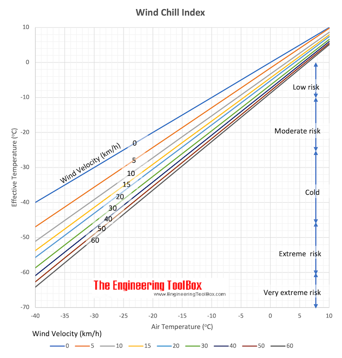

Wind Chill Index - Wind Speed in km/h and Temperature in degrees Celsius
"Chilled" air temperature can be expressed as a function of wind speed and ambient air temperature
twC = 13.12 + 0.6215 ta - 11.37 v0.16 + 0.3965 ta v0.16                        (1)
twC = effective "wind" temperature (oC)
ta = air temperature (oC)
v = wind speed (km/h)
Wind Chill Index -  SI Units
"Chilled" Air Temperature (oC)
Ambient Air Temperature (oC)Wind Speed (km/h)
510152030405060
10 10 9 8 7 7 6 5 5
5 4 3 2 1 0 -1 -1 -2
0 -2 -3 -4 -5 -6 -7 -8 -9
-5 -7 -9 -11 -12 -13 -14 -15 -16
-10 -13 -15 -17 -18 -20 -21 -22 -23
-15 -19 -21 -23 -24 -26 -27 -29 -30
-20 -24 -27 -29 -30 -33 -34 -35 -36
-25 -30 -33 -35 -37 -39 -41 -42 -43
-30 -36 -39 -41 -43 -46 -48 -49 -50
-35 -41 -45 -48 -49 -52 -54 -56 -57
-40 -47 -51 -54 -56 -59 -61 -63 -64
  • 1 km/h = 0.2778 m/s = 54.68 ft/min = 0.6214 mph = 0.5396 knot
Wind Chill Index - Effective Temperature - effect of wind velocity on temperature diagram - km/h and celcius
Download and print Wind Chill Index chart

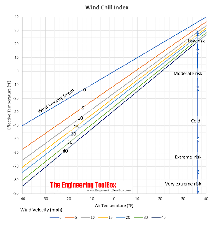

Wind Chill Index - Wind Speed in mph and Temperature in degrees Fahrenheit
The "Chilled" air temperature can also be expressed as a function of wind velocity and ambient air temperature as
twF = 35.74 + 0.6215 ta - 35.75 v0.16 + 0.4275 ta v0.16                        (2)
twF = effective temperature (oF)
ta = air temperature (oF)
v = wind speed (mph)
Wind Chill Index - Imperial Units
"Chilled" Air Temperature (oF)
Ambient Air Temperature (oF)Wind Speed (mph)
510152025303540
40 36 34 32 30 29 28 28 27
35 31 27 25 24 23 21 21 20
30 25 21 19 17 16 14 14 13
25 19 15 13 11 9 7 7 6
20 13 9 6 4 3 0 0 -1
15 7 3 0 -2 -4 -7 -7 -8
10 1 -4 -7 -9 -11 -14 -14 -15
5 -5 -10 -13 -15 -17 -21 -21 -22
0 -11 -16 -19 -22 -24 -27 -27 -29
-5 -16 -22 -26 -29 -31 -37 -34 -36
-10 -22 -28 -32 -35 -37 -41 -41 -43
-15 -28 -35 -39 -42 -44 -48 -48 -50
-20 -34 -41 -45 -48 -51 -55 -55 -57
-25 -40 -47 -51 -55 -58 -62 -62 -64
-30 -46 -53 -58 -61 -64 -69 -69 -71
-35 -52 -59 -64 -68 -71 -76 -76 -78
-40 -57 -66 -71 -74 -78 -82 -82 -84
Wind Chill Index - Effective Temperature - effect of wind velocity on temperature diagram - mph degrees fahrenheit
