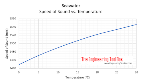

Speed of Sound in Seawater
Seawater - velocity of sound vs. temperature chart
Temperature
(°C)
0 5 10 15 20 25 30
Speed of Sound
(m/s)
1449 1471 1490 1507 1522 1534 1546
