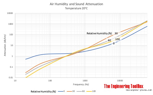

The speed and attenuation of sound in moist air varies with sound frequency and air humidity.
Attenuation and speed of sound in air varies with the frequency of the sound and the air humidity.
Attenuation
Sound attenuation in humid air
Download and print Air Humidity and Sound Attenuation Chart
