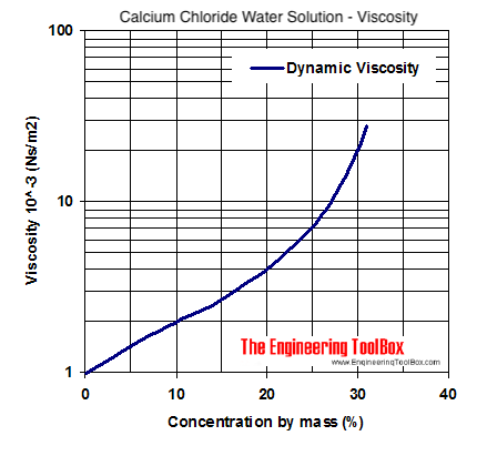

Dynamic Viscosity
Calcium chloride water coolant - viscosity diagram
