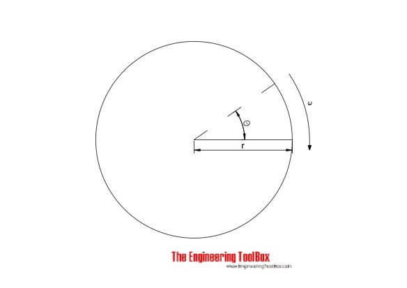

The radian is the SI derived unit of an angle where
θ = d / r (1)
θ = radian
d = circular distance measured along the arc (m, in)
r = radius in circle (m, in)
Since the length of a circle is 2 π r, and the radius of the circle is r - the radians in a complete circle can be calculated to
θ = 2 π r / r
= 2 π
=~ 6.283185
One radian can be expressed in degrees as
1 rad = 360 o / (2 π) = ~ 57.29578 o (2a)
One radian can be expressed in revolutions as
1 rev = 1 / (2 π) = ~ 0.16 (2a)
One degree can be expressed in radians as
1 o = 2 π / 360 o = ~ 0.01745 radian (2c)
Note! - radians are used by default in angular expressions in most computer languages.
The radian is defined as the angle subtended at the center of a circle by an arc of circumference equal in length to the radius of the circle.

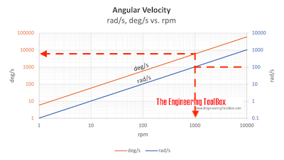

Angular Velocity
Converting angular velocity (ω) to other units
- ω = 1 rad/s = 9.55 r/min (rpm) = 0.159 r/s (rps) (3)
RPM to Radians and Degrees per Second Converter
Revolutions (rpm) | Angular Velocity | |
(rad/s) | (deg/s) | |
0 | 0.0 | 0 |
10 | 1.0 | 60 |
20 | 2.1 | 120 |
30 | 3.1 | 180 |
40 | 4.2 | 240 |
50 | 5.2 | 300 |
60 | 6.3 | 360 |
70 | 7.3 | 420 |
80 | 8.4 | 480 |
90 | 9.4 | 540 |
100 | 10.5 | 600 |
Download and print Angular Velocity chart
Example - Angular velocity 100 rad/s
An angular velocity of 100 rad/s can as indicated in the chart above be estimated to aprox. 950 rpm and 5700 deg/s .
