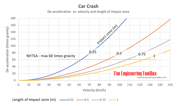

Note! - The deformation slow-down distance is very important and the key to limit the forces acting on passengers in a car crash.

A car with a mass of 2000 kg drives with speed 60 km/h (16.7 m/s) before it crashes into a massive concrete wall. The front of the car impacts 0.5 m (the deformation distance).
The impact force can be calculated as
F max = 1/2 (2000 kg) (16.7 m/s)2/ (0.5 m)
= 558 kN

The impact creates a force 28 times gravity!!
A person sitting inside the car with seat belts on will de-accelerate with a force 28 times gravity . Note that the National Highway Traffic Safety Administration (NHTSA) states that "the maximum chest acceleration shall not exceed 60 times gravity for time periods longer than 3 milliseconds ". For a car crash with 90 km/h (25 m/s) the de-acceleration will be 64 times gravity (same parameters as above).
