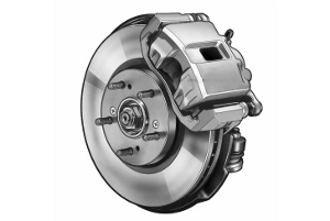

Disk brake - force and torque
The torque capacity of a disk brake with two pads can be expressed as
T = 2 μ F r                                  (1)
T = braking torque (Nm)
μ = coeficient of friction
F = force on each pad (N)
r = mean radius (from center wheel to center pad) (m)
Required pad pressure can be expressed as
p = F / A                            (2)
p = pressure (Pa)
A = pad area (m2)
