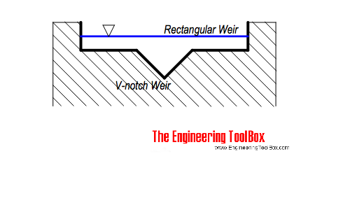

Combined V-notch and rectangular weir
Other available weirs are the trapezoidal (Cipolletti) weir, the Sutro (proportional) weir and the compound weirs (combination of the previously mentioned weir shapes). By combining V-notch weirs with broad chested weirs - larger range of flow can be measured with accuracy.

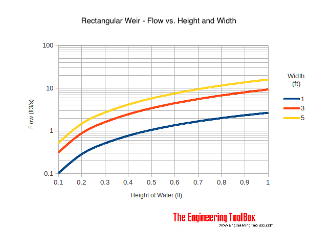

The Francis Formula - Imperial Units
Flow through a rectangular weir can be expressed in imperial units with the Francis formula
q = 3.33 (b - 0.2 h) h3/2                                    (1b)
q = flow rate (ft3/s)
h = head on the weir (ft)
b = width of the weir (ft)
Rectangular Weir - flow rate measurement

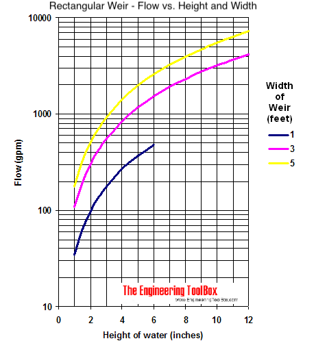

Alternative with height in inches and flow in gpm:
Rectangular weir - flow chart
