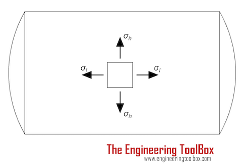

Stress in thin walled cylinders

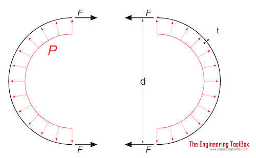

Hoop (Circumferential) Stress
The hoop stress is acting circumferential and perpendicular to the axis and the radius of the cylinder wall. The hoop stress can be calculated as
σh = p d / (2 t)                         (1)
σh = hoop stress (MPa, psi)
p = internal pressure in the tube or cylinder (MPa, psi)
d = internal diameter of tube or cylinder (mm, in)
t = tube or cylinder wall thickness (mm, in)
Longitudinal (Axial) Stress
For a cylinder closed closed in both ends the internal pressure creates a force along the axis of the cylinder. The longitudinal stress caused by this force can be calculated as
σl = p d / (4 t)                               (2)
σl = longitudinal stress (MPa, psi)
